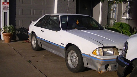

    Bondo'd back quarter, curb rashed air damn in front.

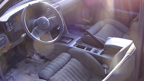

    Missing carpet reveals soft back floors in back seat foot area- the hatchback must be leaking. That is the low spot of the car. The rest of the floors are solid.
    Only opens from the inside door handles, but the PO included a new set in a box.

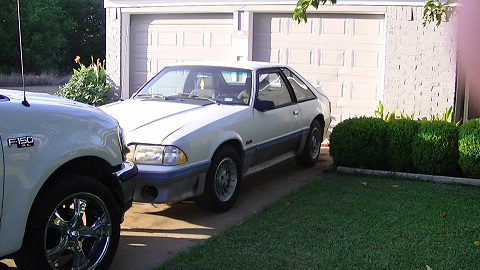

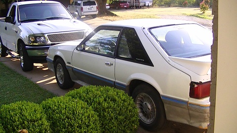

    Going to pick it up this morning, here are the "better looking than it really is" listing pictures:

    still has a/c connected, the EFI harness is stil in place. The front end is actually decent looking, like maybe it hasn't been pushed into anything. It reminds me of an auction car. Almost done project that somebody gave up on.

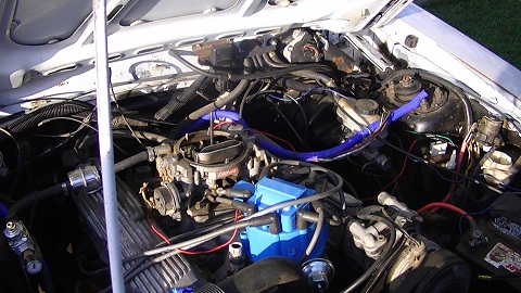

    the engine picture almost shows the adjustable fuel regulator for the carb, an Edelbrock AFB thing, looks like an early 80's intake and the valve covers say older 5.0 from a Mustang. I am thinking about getting a scope from Harbor Freight to see if it's a roller rather than pulling the manifold to see.
    4 maypop's, but the turbines look usable. The hood looks wrong because it's not bolted on. I just noticed those are LX lamps, damn. I woke up thinking Cheese Graters! I'm thinking polyurethan to fill in the death gripped steering wheel and a cover. PO says it's got new rotors and four wheels worth of new pads. Pedal felt good.

    Take junk from pile of parts laying around and put the EFI back together... maybe. I've got all the stuff to put an A9L , MAF, 24# injectors, eeee cam, ~320 hp 302 back in it. Then again, I've got a funnel web single plane, xe274 roller cam, and a 750. I will decide by the end of theday.
    My feeling is the bbf should stay with the Lincoln for now, so it's either a 302 or a 351 for this turd. I'd need a pan and pickup plus headers for the 351 and it would be carb'd.
