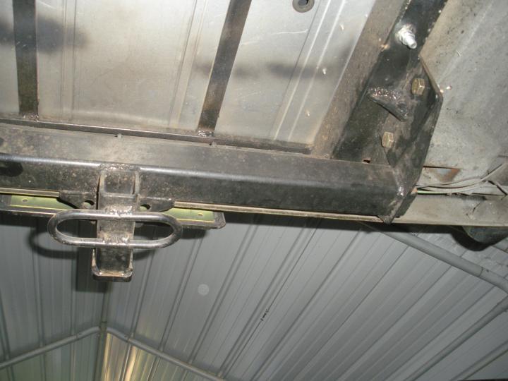

                Good looking car. We scratch built a hitch for mine kinda like what Bill did on his Mustang. I've included a few pix of the setup. I bought a receiver and we basically built the rest around the location of it. Although it's a back half car, I think you can do something similar with a stock frame rail car. We welded (you can bolt on) a plate on each side for a solid/ stable attach point. Then we made the hitch assy as a separate bolt on piece but it's really simple. Square tubing going through more plate with receiver welded to it. We then took a piece of round solid stock and bent a loop out of it for the chain attachment. It's made it through two Drag Weeks plus local testing so it's solid. The trailer is just a Harbor Freight special with the 12" wheels.
                Outside shot showing the plate welded to frame and how the hitch assy bolts to that.

                inside shot shows clearance available.

                This is all that shows from the outside.
