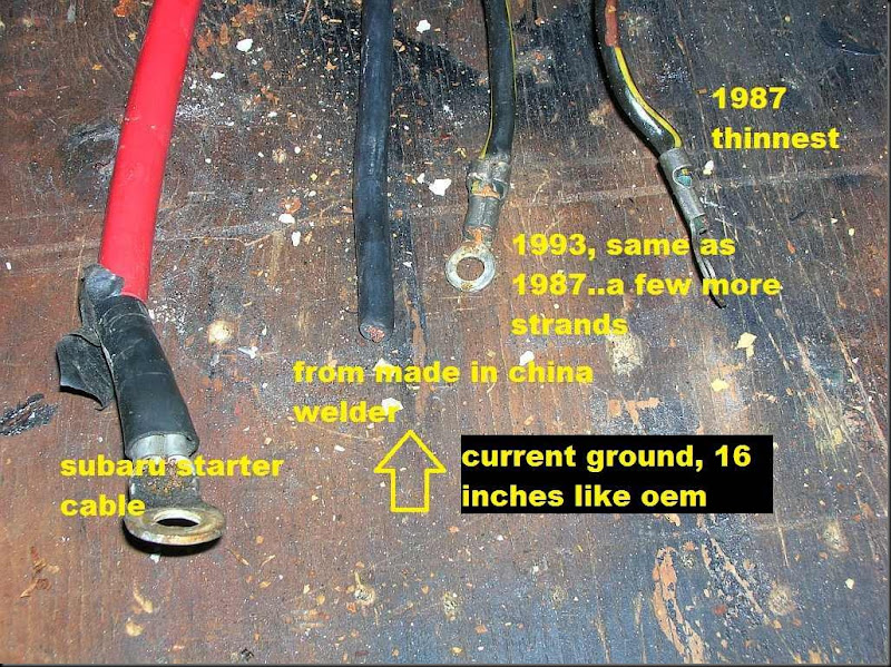

          here is the last anal retentive extra terrestrial trial and error chore...(err: japanese)
          I am one who counted strands to make my own fusible links...but simple engine ground? why why why did it go this einstein on itself.
          the welder ground version seems to be the good answer...and nicely high grade.
          shrugging it off, and driving on..
