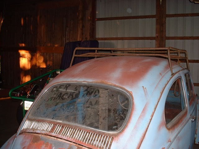

    In the beginning, we drug this mess home because it had a nice hood ( and the car came with the hood, old dude wouldn't part it out).
    After it fermented further in the barn for a few years, and my wife & I having a couple of boy-childs in the meantime, I found myself in need of a family 4-seater for dune cruising. After a brief flirtation with the idea of a full length 'glass buggy with Thing suspension............sanity prevailed and then receded as this idea came about.

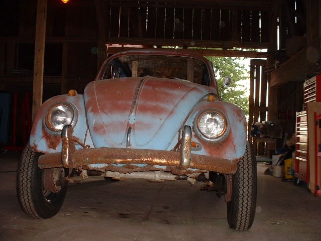

    So after moving 3 other "junk" beetles (hey, I considered this one junk and changed my mind about it, anything can be fixed) it lurched/rolled squinting & bleary-eyed into the early morning sunlight....
    Click image for larger version  Name:	bWNyLnF.jpg Views:	1 Size:	84.6 KB ID:	1192174
    Poor little thing barely made it into the shop.

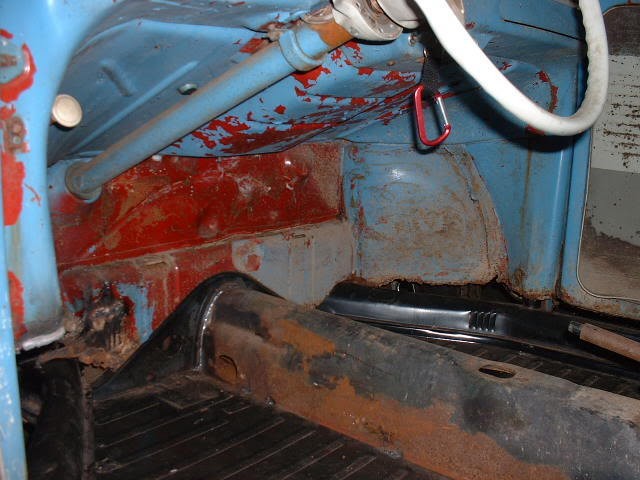

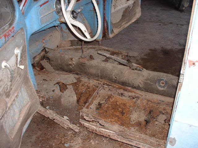

    Now I want to warn all you folks out there in the Western United States - THE FOLLOWING IMAGES DEPICT SOME DISTURBING AND GRAPHIC IMAGES!
    This boys & girls, is rust. Not sun decay or metal fatigue, but rust.

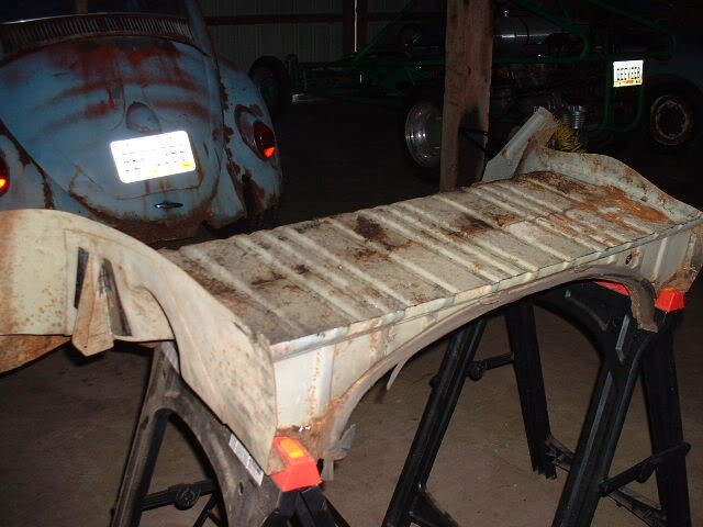

        The few bolts that were left came out suprisingly easy, only 1 broke (gas tank hold down, go figure.)
        Of course there were a BUNCH that did not need to be addressed whatsoever.....

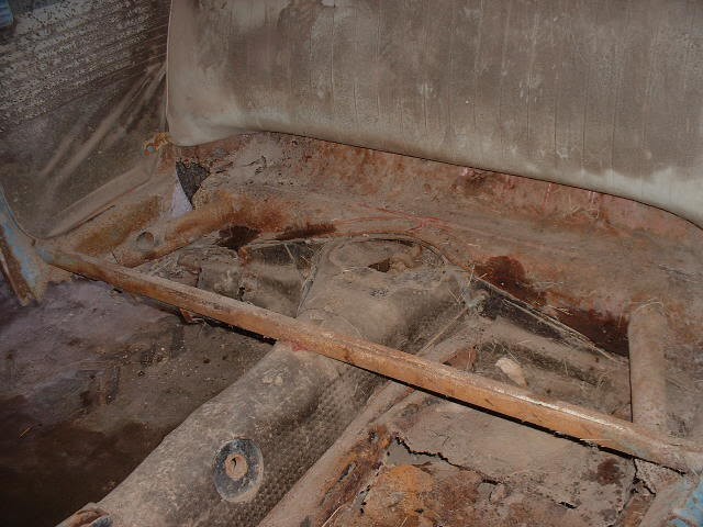

        Even though all the bolts were out, the rear crossmember stayed stuck to the pan - and took the package tray with it. Look close at the previous pictures and its understandable.

        So we sourced this piece. Thanks to thesamba.com & greyhound busing for existing, I would have never found this stuff before the internet.
        Just to act as a jig, it was sat down on its "new" pan with new floors/hat already installed. This let the new heater channels be bolted loosely to the floors so that the next step can be figured out......where do you start when everything is COMPLETELY shot?

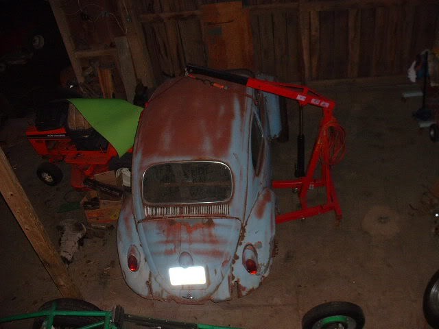

            Passenger side b-pillar "area". No laughing at the 2x4's unless you submit a better idea......they are all that is holding up the rear of the body, going from floor to roof. My hoist was tied up with another project.

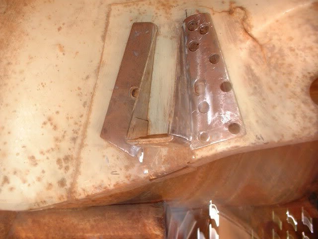

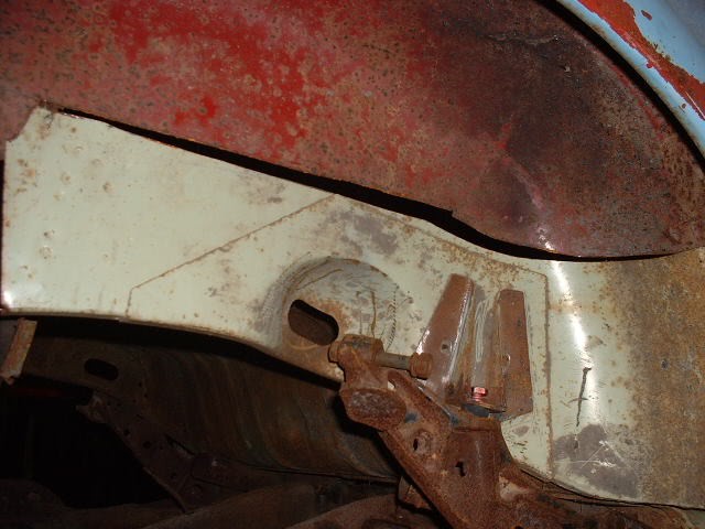

              Some of you know the drill, when an early body goes on a later pan, the rear fenderwell body mounts must be shortened approx 1 1/4".
              So here's some pictures for anyone who might be curious....
              The cut marks laid out.
              Was originally going to drill the spot welds and move the whole bracket up. Yeah. Think they used enough spots there?
              This piece needs to be a little narrower for bolt hole alignment.
              Taadaa.

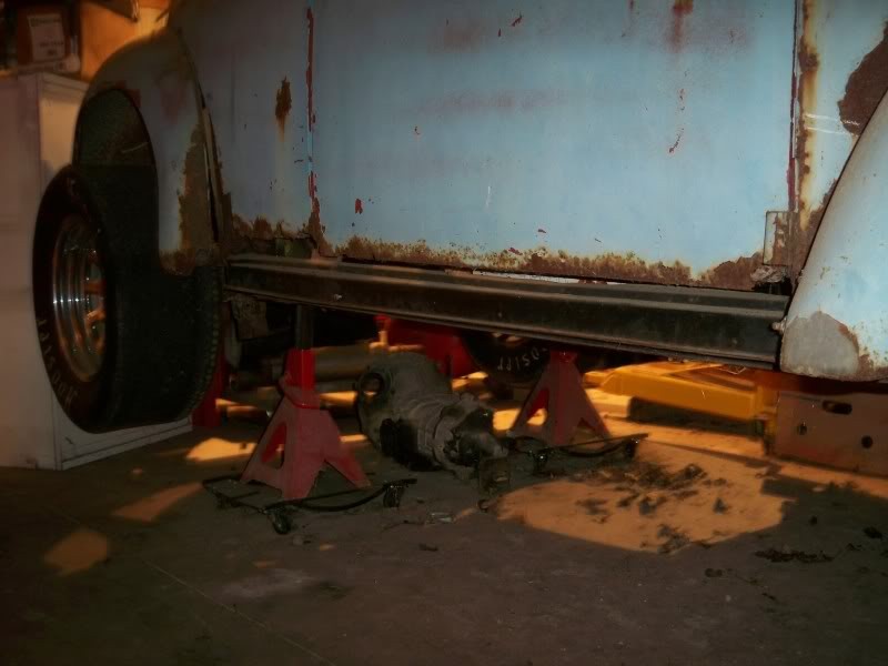

                Ran into a new "issue"........I've never had to cut this before, and I've never heard of this needing clearanced when putting a early body on a late pan.
                But this one sure needed the body mount casting on the pan trimmed. No way it would clear without.

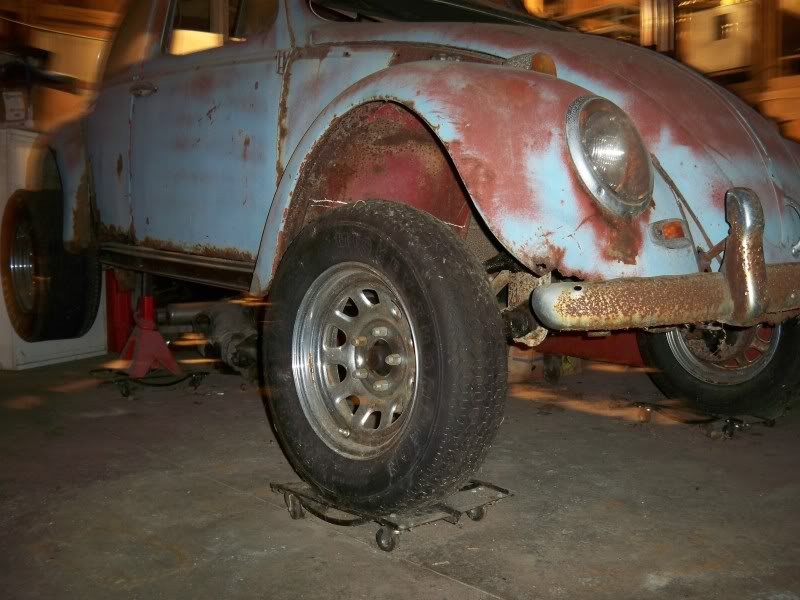

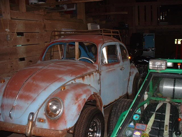

                  Here's about what it should look like when done. Think "patina" real hard, not "pos". Should give the local fuzz something to think about at the very least.
                  Click image for larger version  Name:	6Esz3cW.jpg Views:	1 Size:	70.6 KB ID:	1192194
                  The rear will come up another couple inches, still have to readjust the torsion bars. And I found a bumper for the rear with just the right amount of nastiness.
                  And back on the stands for the next round of cutting.
