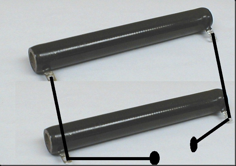

    new carb resistor
    photo shows parellel setup
    browsing around seeing what is out there to simply place next to a straight section of steel fuel line near the carb to act as a heater. the 56 ohm resistor was nice, it did get warm..but I want to drop volts even further (disperse more watts) and increase heat. sure enough, found this fancy one with accurate numbers written at the 12v setup and watts dispersed (compare to a lightbulb). the one above is stand alone.
    just one resistor is:
    @14v, 98 watts dispersed as heat (7amps). Even at half that more heat than I have now. This will also keep the ground side , where I screw it to top of carb, to a lower volt.
    I was messing with fuel pump to find an always on source with key, and was playing with throttle when there was no pump during runtime. the hesitation almost stopped somewhere between full float bowl and empty. Rather than try and find this exact sweet spot of weight in the bowl, as maine changes from 28 below to 90s above..this heater defies all that, and moves the goops that build up in a cold carb as well. Not to mention the ground side is screwed to top of carb, further synching a mystery, like a gadget on a feedback setup...only much simpler.
    with an igntion big enough to be audbile, like amobile home furnace...
    this should get what I want.

    91 F outside and I am making a fuel heater. A large 5w resistor from my burnt mig welders little pcb turned out to be a nice hot one on 12v. too hot by itself, I reamed the end you seein photo just to get the square ceramic box resistor inside the old mig welders tip. all copper, resistor electricaly sealed on its own..very nice transfer of heat. this passes the electrical tape test, and will always be cooler because of frigid compression on the fuel line..even today…at 92F outside and an odd X-flare storm, that line is darn cool. This will get it where I want it. The length of it allows me to move up or down the fuel line, about a foot of straight line right outside the carb, to adjust. Sealed with high temp copper exhaust silicone by permatex. for the connection, soldered leads and heatshrunk. this passed that test as well. solders did not melt.
    4.4 ohm. on a 9.6v power supply, the output was 5.6v. I do not know what twelve is going to do, and do not need to care. it may be more gentle, may not. will test soon enough.
    kinda like winter outside. too cold and one stays in...too hot and it is the same. will wait for sealant to dry and plug this right in. it is a hot one. maybe wrap it again in soft aluminum, and use a clamp, no taping.
    530. installed this, clamped with a thin clamp, it did get a bit warmer than the 9.6v power. Carb stays cold, but line did accept heat. This is very noticable in the winter. Driving for some time with the heater the carb seems to clean up something. A smell of road kill for a minute or two, like the last time, only it was the dead of winter -the same thing. Something does puddle up in the carbs. heavy settle, light moves. Agitating it like injectors nearly boiling fuel before it gets to a cylinder does work. cough dwindles to hardly bothersome. This fuel heater is hotter than that first version, and proves to need it. will wrap it once more to avoid getting burnt fingers.
    830. got a little ride in..seems jumpier than ever. wrapped in a coffee can then electrical taped, a clamp keeping pressure for heat transfer, over the can keeping it more sealed to the line. it absorbs all of it, does not even get luke warm. Very very hot little heater I made there. I even doubted the wires I used...but its hanging in there. increased fuel pressure may be the cuplrit..I have it passive through a .030 restriction back to tank. This was jumpy after first line heater, and it went to very nice eventually. Don't know what I did. I'll let this go. most likely moving some crap around. pulling back in the idle was a tad stronger, I mean a bit more full. I did throw alot at this... just drive.
