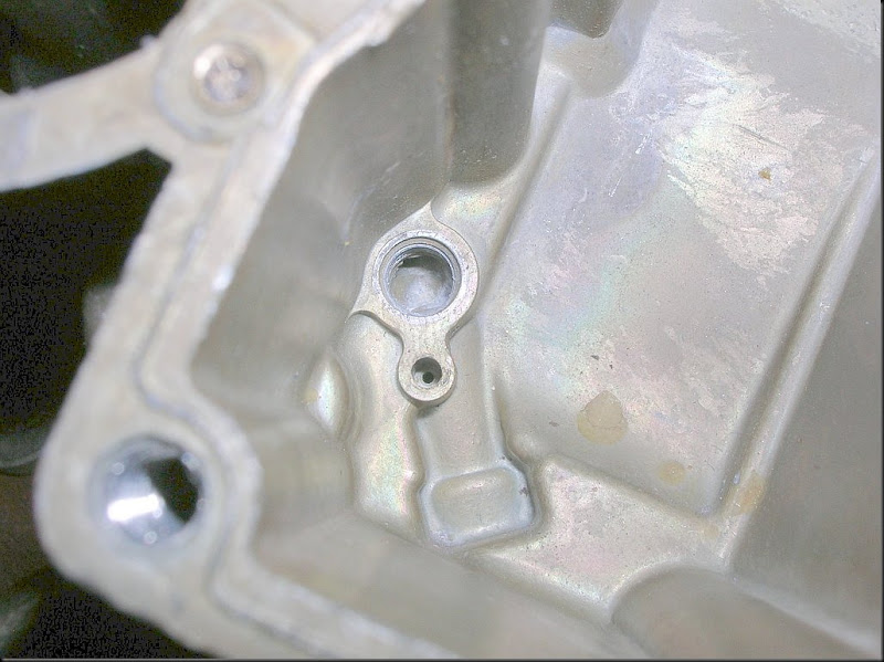

      the little hole that gets covered next to the pressure relief bolt, and glimpse of the spring. even on the old pump, the old line of where bolt ended showed how much was covered. this one ran perfect. the HG fail sent some casting sand into the shaft and it became sloppy. with stuff spewing everywhere, including out the oil dipstick, boiling..I could here fires in places that should not have had one. I pulled it into the garage on two cylinders and oil pressure at exactly 43psi..right by their book. amazing misproportion? no way. they need to do this for every machine.
      I think the pump could do four v8s all at once.
      oil pressure works via an external mounted trochoid. A robust one at that mention. I dropped the pressure relief bolt (it actually is a regulator) behind it is a spring and cup. I analyzed the old pump in the parts bin for the 100th time and still confuse myself without the manual right there with arrows and diagrams.
      I found a problem with relief bolt that holds spring in, it takes up what would be on the backside of the cup. A little passage way partially covered by the bolt itself screwed in too far. I remember tightening that in a maine version of tight and killed the washer and dug into the pump hole. this means fluid motion going jerky, if that passage is too tight.
      spaced the bolt away from pump more, gave it all the opening it is worth, this gave the fluidity I was looking for.
      what does this have to do with a monojet? the pcv out the other end of our engine sucking on everything also pulses to whatever the pump is doing... more than the carb throttle. so, this is the last helper for that. next is just engine too old to run.

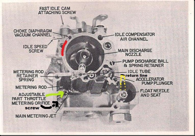

            I don't know why they call it the part throttle screw.
            "the part throttle metering orifice” screw. I found the little chevtte carb had the same screw. no change n taper, threads, length. The chevette carb was brand new, so I took the screw out and swapped it into the car’s truck carb.
            upon further analyzing.. I did miss something. the size of that hole in this chevette carb is at least 70% smaller than the one in the car now. I turned screw in all the way, let it out 1/2 turn. I used to have it at 1.5 turns. No leaks, I won't have to cap it. can get at it for future adjusting easier. no difference in runtime yet to notice. A longer run in coming days. something is stuck in something, valves rapping. This is even more MPG, the tighter I can keep the screw in.
            I had an intuition that the truck carb unscrewed itself behind the permanent cap. after drilling cap to get at screw, I noticed it was way out. wherever the truck carb came from seriously must have been single digits mpg dumping fuel all over.(truck carb simply refers to the 250ci, the exact serial number for my carb puts it in a camaro straight six)
            edit: the cold start. best one yet. that is about all I noticed so far. I did not go to full warm, or even drive..just cold start.
