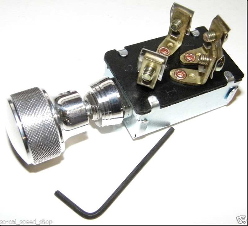

      the intake heat controller. I started first cold start today with it inside car. not much of a chill in the air, but it did drop to 38F last night. I like the thought of that controller after prying some icy doors open and dreaming of my run to get some hot coffee some place. I am finding choke back to full on, and cold start like the old days, intake heater off is the genuine routine. once started, crank knob to wherever. When the bimetal in the controller is cool, like the duct outside..the heat stay on longer for initial warmup, then pulses in shorter intervals as car warms up. Clever. I did not think of that part of it. The colder it is, the longer it will stay on. Could not ask for much more. this also means as cabin heat increases, the switch will get shorter intervals. That is not so good. As outside temperature of duct needs to be in equation. I'll possibly think of something else to go along with it. finding a cool spot for controller is a must do. maybe remove dash clock, as controller seems to be the same size as that hole it is mounted in. nice cool windshield not far off to keep bimetal active.
      for now, pretty darn good. the amp draw is large enough to change tone of engine like an a/c compressor with off on intervals. The battle is on. this anything but formula 1 monster needed every inkling of it.
      found spot for controller. this is inbetween heat ducts, seems to be cooler. the off setting is really an off today. electronics, even basic..peculiar stuff to layer in at an invisible layer. the dual range sticker is in this photo as a mystery to the need...

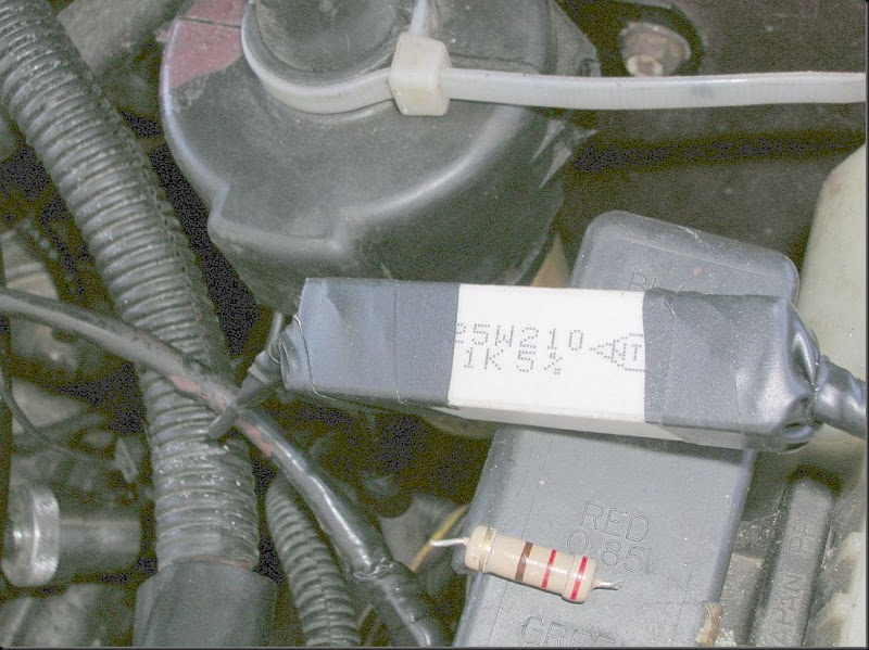

              the battery connection from ground to alternator..(the letter E in photo.)
              damn that got important. I got a rich odor after car started, hard start for a not so cold start..a big ignition was fixing that for a time. I knew something was gong lame..as when it started, it was like a switch found a ground. big start..what was takling so long? and why rich after that ignition pulverizes everything in the chamber?
              the wire was unhooked for reasons I forget.
              this was not hooked up by factory. I thought I was giving a simple extra, but am wrong indeed. Being on your own with upgrades..no one knows the backside of a chassis until trial and error.

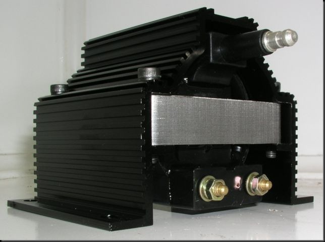

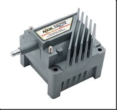

              the E wire does not apply to the pipsqueaky origin of this midget monster. the 5k volt coil did not need more than a 20 gauge wire to gound. I found it along the way, just upgrading coil, and battery, then all copper radiator..
              nothing extreme. It does need it now however...it took 4 years to find that one.
              a bigger exhaust can trigger this problem as well. the alternator needs battery negatove to function regulator precisely. I found the internal E connection, and it simply used the block...not good enough when flow is in the middle to disrupt the bigger ground connection at starter..the other end of engine. it literally loses the whiff of battery, does not know how to regulate nice once things get big. Seems simple now..I had no real clue until learning myself the hard way.

                  ignition was literaly dual 12v positive for no reason at the disty. Accel fixed a huge freaking problem.

                          I also found, oem ignition switch is useless if to go aftermarket ignition, the fuel pump runs on 8v low mode by factory, and even slower if the car has an ecu for injection. That all has to change to stay safe.

                              accel electronic supercoil

                              custom ignition switch, wiring, fuses (nicely done, no hack splice)
