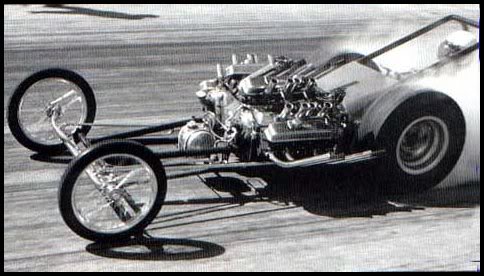

    I have been following this on the HAMB, and I think it's the most kick ass build I have seen. I have the plastic model of Tommy Ivo's four engine car, and even in scale it's an intimidating build.
