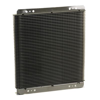

    I think the plate type coolers are much more effective at dissipating heat, like the B&M Supercooler.. I have that type cooler mounted right behind the rearend w/ a fan built right onto it.. I don't think synthetics are as good at removing heat, so you may see a drop in temp., but internal parts could run as hot or maybe hotter.. The synthetics can tolirate heat better.. A LOT of the guys running big turbo cars where the trans temps can get crazy are running hyd. oil, not trans fluid.. I run pretty standard stuff, but it would be easy enough to find out..

    My converter stalls 4600 on the brake. I run Royal Purple trans fluid. I have the largest B+M stack plate cooler they make that comes with a fan. It is mounted under the bed, blowing air from the top to bottom. With the bed loaded, and 2 people, I would guess the truck weighs about 4200 pounds. I monitor the tempature of the trans oil in the pan. The highest I saw last year on Drag Week was 210 degrees. Most of the time it ran around 190.

    Talked to jeffmkc on the phone and he agreed...I'm gonna switch to Amsoil and get a large b and m stack plate type cooler and see where that gets me. Even with the two large tube/fin coolers I'm running people say they don't work very well.
