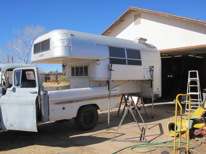

    Anyways, I got the 3 jacks working and with some front/back diagonal bracing. The camper is sitting on them right now (with the steel sawhorses an inch below to catch it if it falls). It's pretty wobbly side to side, but it should be ok for loading the camper if I do it quick
    I'll probably make a riser platform for the camper right now, and set it in the truck if I can. The bottom of the camper needs to sit about 4-5" higher than the current floor of the truck bed, so the overhead will clear the cab. I'm just going to make a quick 4' x 8' thingy out of 2x4s, one vertical over one flat along each edge.
    I took some pics of the jack reseal thing, but I'll post that later. For now...a pic of it being supported by the 3 jacks.
    back to work! I had to come inside to get my framing square

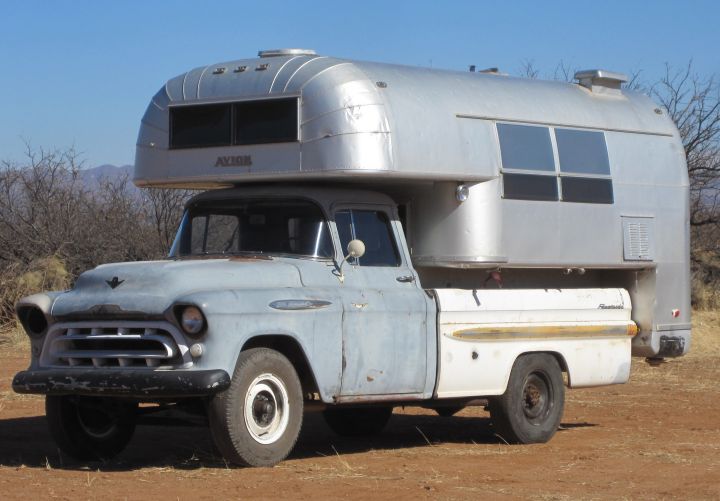

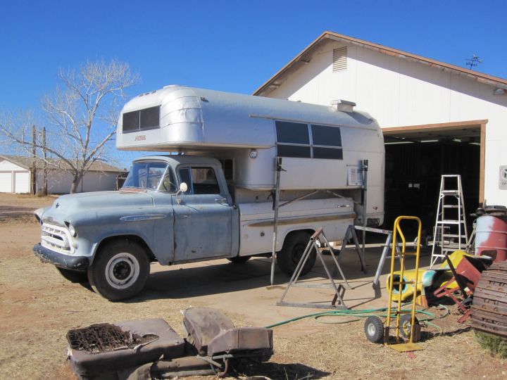

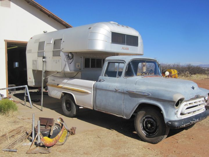

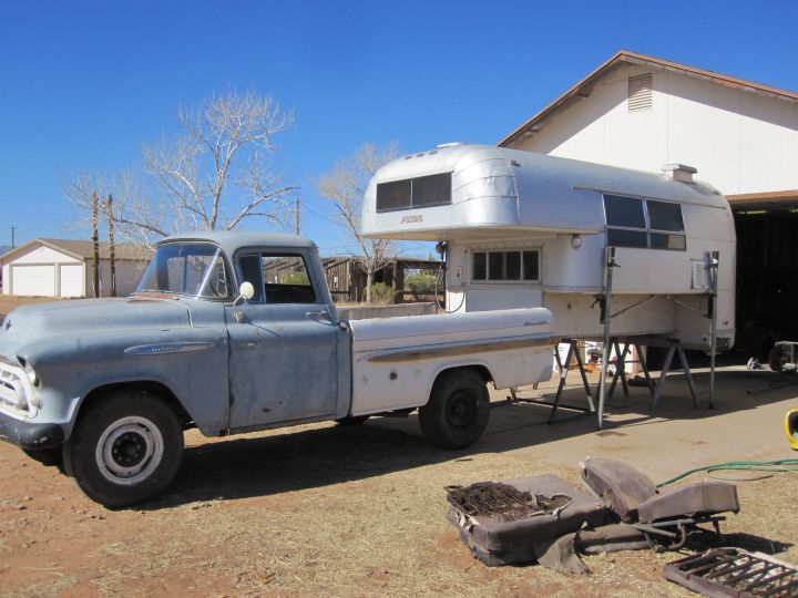

    Anyways, I got the camper setting on the truck! Wasn't too bad.
    First I made the pallet so it would clear the cab roof
    then I raised the camper, backed up the truck, and moved the front sawhorse back a bit
    I had to keep raising the camper as I went back. The loading instructions for the camper are adamant about keeping the nose higher than the rear. Makes sense...that way it will slide in, not catch.
    and ta-da! it's loaded
    Big block and even sized tires front and rear will help get the nose down, but I may want to add spring spacers (blocks) in back to get it up a bit for when it's loaded with water, stuff, etc. Seems it's pretty common with these things to need to raise the back of the truck, even with a modern dually one ton.
    The springs are still arched the right way, they just don't sit high enough on the frame, because of how the perches are. 2" blocks should fix it.
