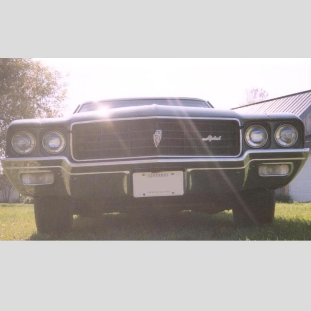

    Has anyone here done a mild build on a Buick 350?
    Right now my Skylark has a 350 2bbl motor that has a TA 4bbl intake, a petronix points conversion, and a 570 Street avenger on it.
    I'm thinking of upgrading to headers, and maybe a larger cam, a small bump in cam size, and new rings if I need them.
    Right now the motor seems to be out of breath around 4200 RPM and I'm not too interested in pushing the peak RPM much higher.
    Anyone have some words of wisdom?
