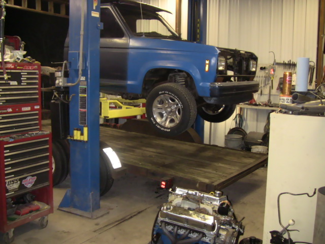

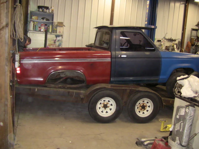

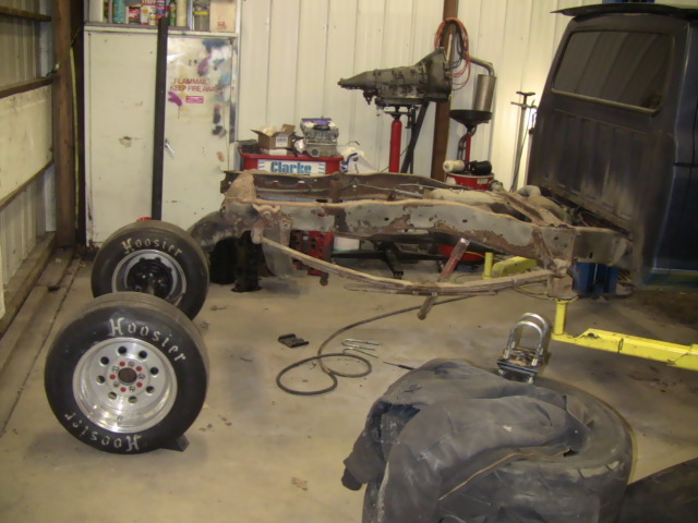

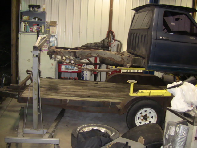

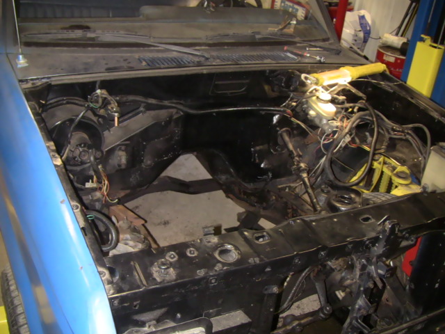

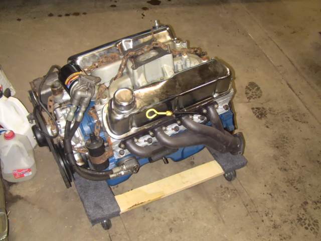

    After a nap - we got back at it Saturday morning, and by 11pm Saturday night the engine, trans, axle, msd box, gauges, shifter, etc were all out of the ranger, the ranger was on the trailer - and the splash box (which is HEAVIER than the steel stock box) was swapped out for the steel box that fits much better..... the truck is just missing some white to be a patriotic paint scheme...

    The Falcon got a serious bath at the $0.25 car wash where lots of it's shabily applied dark blue paint washed away with years of grime. Matt got the tires to hold air, one front brake un stuck, and the falcon was rolling on it's wheels with a bit of human power into it's new home.

                              Since the 302/aod/8.8 are already all rebuilt and ready to go (aod will go back to trans shop to fix the "won't upshift" problem)
                              That powertrain gets the nod, with a few mods:
                              Edelbrock aluminum 1.90 intake valve size heads - probably swap the valve springs to match the x303 cam.
                              Those require stud mount rockers - which are on the way from Summit.
                              picked up a ready to run msd off craigslist for $100 - need to swap the gear to match the roller cam.
                              dual quad offy intake $50, one 1405 edel $20, rebuild kits $20 each, calibration kit $60, and still shopping for another 1405, and a big thanks to Jay for the linkage.
                              Headers will depend on how much modification is required to get the hedman long tubes I have to fit.
