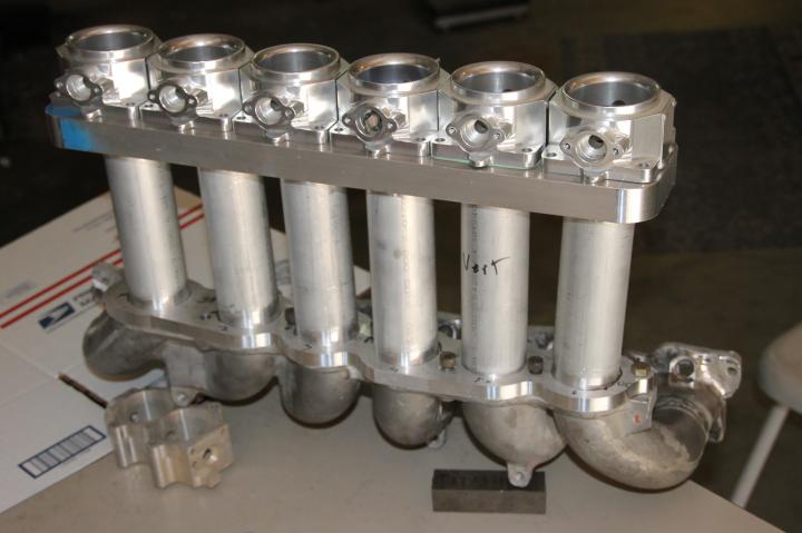

    The phone rings, and you dont know whats going to happen next sometimes...But the request for a landcruiser straight six straight stack induction system for speed density EFi I got last week was pretty strange. After trying to steer the customer into something a bit more "practicle" we went for it. Its almost done, and here are the results:Click image for larger version
Name:	LC1 progress4.jpg
ID:	879176Click image for larger version
Name:	LC1 progress3.jpg
ID:	879177Click image for larger version
Name:	LC1 progress2.jpg
ID:	879178 After doing some basic research I found that the rest of the world is full of these toyota motors (not the US though) and the mods for these motors get pretty wild. We gundrilled a common plenum between the intakes in the TB mounting plate for the MAP and IAC and Im alsmost thinking this thing is going to work, after they cut the hole in the hood! The cast portion of the system is from the original two piece common plenum manifold, and the ports were not in any sort of rectilinear order, hence the slight angles on the tubes. Not sure if it was worth missing speed week for...

        What sort of throttles are they?
        • BKBridges
          • 918
          We make all or our throttelbodies "in house". We wanted to put some 48mm units on it, but the smallest individual bodies (1 bbl) we had made to date was our 52mm "flat head" units. We dont have any "standard" stack TBs stocked, so we used these, which are a variation on our Viper/Jeep throttle body design. The tubes are 46mm ID. We are looking at some alternatives for the next I6 systems as 52mm is a bit big for the 4.5l motor.

                Youve got the MAF version of the FZ, The later units (2000-2008) are speed density with a slightly different intake manifold (not so "triangular" in layout) Cant do stacks on a MAF set-up, at least Im not sure how to! Im approaching this project aesthetically as I have no idea how the performance is going to be affected...Hoepfully good torque and a nice bump in WOT...Its what the customer wants! Nice header by the way!

                  If you went with a common inlet with one MAF you could do it that way? I guess it would defeat the cool looking six single filter setup though. Could do this kind of like a BXR setup for the Mustangs where you could tailor runner length, send several lengths and let them decide which one fits their needs best? Very cool looking...
                  Do any of the motorcycle or boat throttle bodies look like they would work?
                  • BKBridges
                    • 918
                    Im working on a 4x18" air cleaner for the stacks. The TBs that we're using on this one have a nice ASME inlet so they pull from a plate well. In the future, on this system we will use a smaller pattern TB thats "in the works" (sitting on my CAD machine's screen). My original design for this system used our Victory motorcycle throttlebodys (3 2barrels) with 9" stacks on top, but the customer wanted individual bodys. Being primarily a throttle body mfg., F&B tries to keep our designs all F&B, but 6 Harley TBs from Morelli would look real nice on top...

                              Since we were rushed on this project (3 weeks from phone call to delivery!) we were not able to deal with the air cleaner element design very well. The kid that works for us tagged the element spacers to try to hide the ugliness... dont think it worked. The rest of the system came out nicely, but we had to create a linkage that would reverse rotate one of the bodys to get the factory Toyota TPS going in the right direction. I found a different element from K&N this morning that will work out much better in the future. Im hoping the bottom end is big with this system, but who knows...Its all show at this point.
