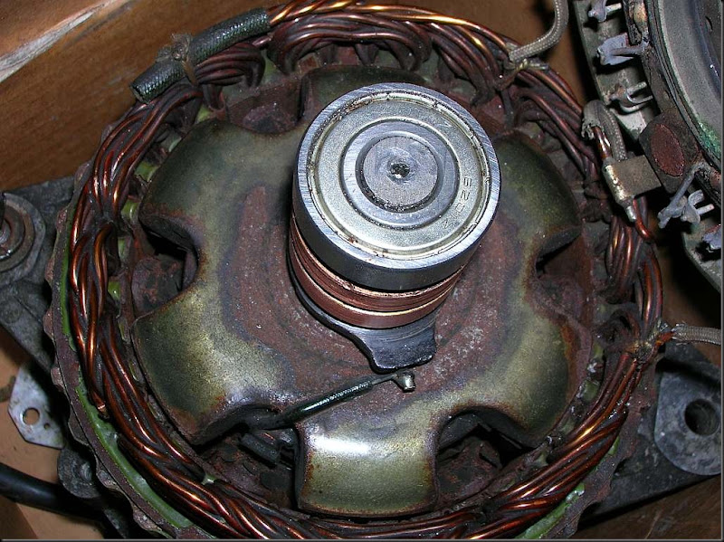

    the metal with posts come through the back of alt. this is how I determine age. This one is young..maybe they did replace something important. bearing is like new as well. same for the front.
    sanded up slip rings..also young.

    alternator bearings
    A glimpse of the alt bearing, rear.. I thought “no. could not be.”
    yep. it is the same exact size as the pilot bearing for clutch. the silver new one is from a spec stage 1 set, that I never used. Given the alternator in photo is nearly brand new, it won’t get the bearings. The right bearing is simply from yet another, even younger alternator… will save for a special occasion. I also have another case half..has not even been used enough to gather a dusty mess.
    The alternator in the car may get the new bearings..there is a resonance occasionally on the way to warm. Still very nice however.

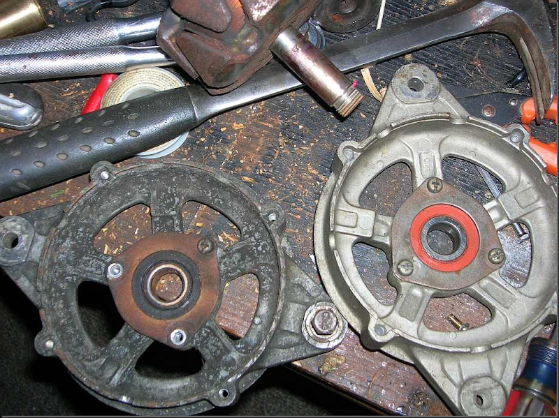

                      Feeling brainy today..I realized the old bearing on the alternator to be rebuilt really ought to go. Here it is pictured with the bearing that came with my spec stage 1 clutch..The alternator bearing is the same as a pilot bearing. I only had one problem. the bearing was 22 years old.. pressed on. without the 3 dollar mini gear puller that I break even on japanese sized stuff…
                      I made this from the pile below to be a puller. Some ghetto suspension droppers, some threaded rod, etc. Sounded like a big gun going off when the stubborn old bearing finally let go.
                      The old bearing had plastic sides, as alternators do play with juice, I am sure the metal version installed won’t hurt anything. I put the new bearing on with some high temp wheel bearing grease..not only for another future rebuild, it is anti-magnetic.
                      front bearing is very easy, that comes next

                          this was stubborn. the left grungy one was stuck on the browned shaft of the front of rotor. 8 inch gear puller to the rescue. Can't just smash these around. the nut is easy enough to get..but the rotor. its a goner once its gone.
                          lucky save..it did need a front half as much as the back.
                          I decided to just swap the whole front end. so this makes front and back half, both bearings, a volt regulator and brushes. the stator and rotor is the only original..lo and behold, those last forever. The old alternator was infected with something. I do not even trust the alloy. As if annealed squishy. Saved another one.
                          this is being done on my own as 3 remanned alternators had something seriously wrong. looking nice and clean..they were a monster. I found mismatched brushes, some longer than others, and old style regulators (heavy stampings - I guess this creates a problem). The one in car as of now, is perfected, as this rebuild will be as well.
                          the rebuild will be even better, as regulator will have no stamping on the cover at all..and brushes from the same company. the last little tidbit is a new nut for the pulley up front.
