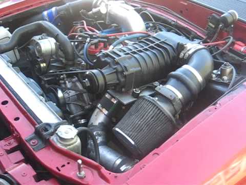

    I was concerned if I did a blow through carb set up....the blower would keep producing boost even when the throttle was closed. But this video reminded me that the factory bypass is vacuum referenced, so throttle blades closed, no boost.
    This video was also good because it shows how an intercooler could be added to the setup. Eatons make a TON of heat and are nicknamed HEATON's
