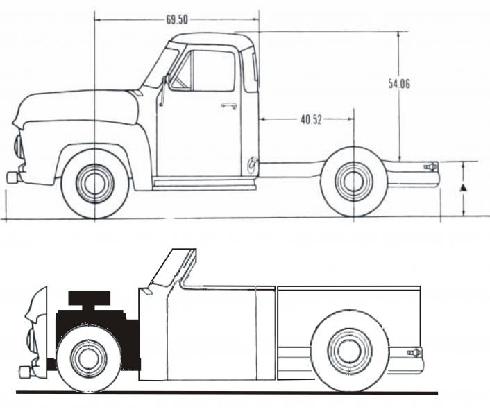

                          Re: the notso pretty 56 F100
                          figure i should do some kind of update, i spent a good part of sunday last week trolling thru a collection of chassis and suspension books i have then tonight sat down and did a rough and boy do i mean rough idea of what im thinking i want to do, i miss my old fenderless roadstered vw bug so i got to thinking ....Name:  113d7ce128d538d8231cf93bd698736f.jpg
                          i want to keep the same wheel base, move the cab back on the new frame, make a new firewall, and a custom bed, cut up the front clip only using the nose along with sectioning and narrowing it
                            looks great.... will it be ready by Powertour?
                            • #59
                              Sorry - I'm going to have to be the jerk on this one - if you want to cut up something to make a roadster out of it - why would you start with a very sought after pick up body style? I know it's rough by TX standards, but as a rust belt guy - I'd hate to see you cut it up, but after a few beers - I might help! LOL
                              • #60
                                Where Boooghar lives rough is rough even by Michigan standards... dad's Taurus and S10 both ate rotors from rusted up caliper pins from just parking there half the year (he drives back and forth from there to Dallas). I won't say it's humid there either, but during our drought last year, notice the pretty green grass and happy trees everywhere?
                                You can just about rebuild the thing from a VIN these days, if he hates it too much there is replacement metal was my thinking.
                                I may have asked this already but I'm all fubar on the flu and pain meds - can you put this on an S10 chassis? A V6 and mini-blower would be righteous on this cut down dealio. Freiburger did a 300hp 4.3 about 10 years ago that I think would be cool as hell here.
                                /edit - 2002, It may have had a Vortech on it. I thought I remembered a Weiand.
