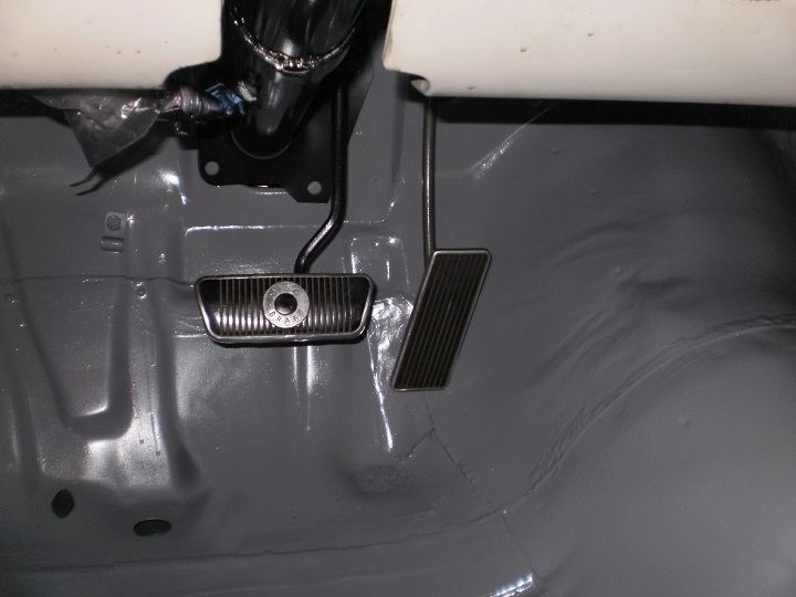

                  Small Stuff - Pedals
                  Got these back in; they're solidly mounted and nice and tight (no side-to-side play). I've replaced the puny self-tapping screws that were orig used to mount the accelerator pedal bracket to the firewall with stainless nuts and bolts.
                  This wasn't one of those jobs that was on the 'master list', but if something's lying around and I need the space, it's just as easy to refurbish and re-install it/them on the car -- just as long as it's not going to require taking apart again at some later date.
